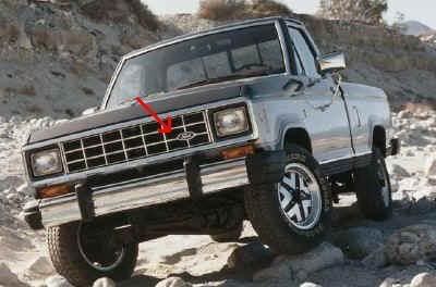

hey, one of my fenders is squat on my 88 BII and needs some pounding out and some sanding and primer but i got all the bolts off and soon as I took the grill off to get at the bolts holding the front of the fender in, one of the screws inside is stripped and I cant get it out. and its in a hard place to get at,
its inside one of these slots as shown:

if you can hold the shaft or otherside of the screw with vicegrips, clamp them on then try to drill the head out with a drill.

worked perfect man never even used the vise grips, i was on the last bolt of the fender adn had to come in for supper and were having cooked supper so i wont be out for another 10-15 minutes lol
thanks for the method i wouldve been bored outta my mind if I hadnt got that off, thanks
