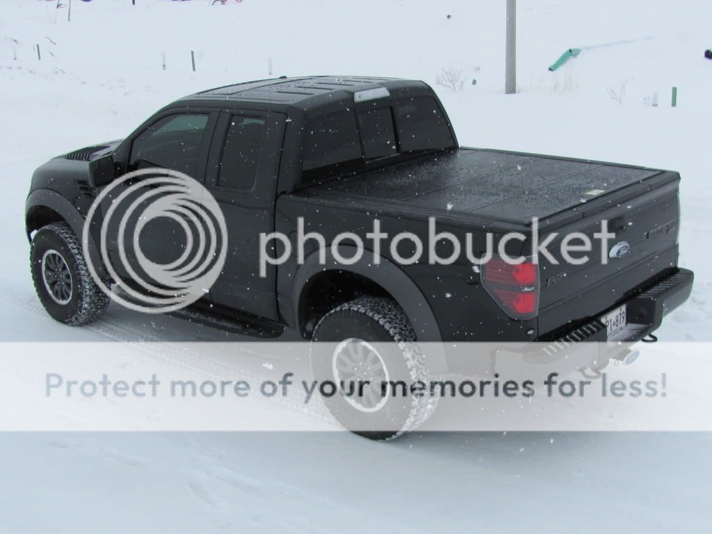

Time will tell, but for starters, here's a quick "before" pic ( from Feb/2011) to keep things moving......
