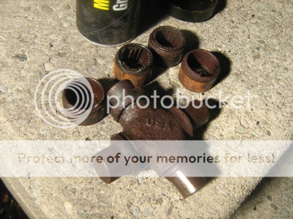

So heres the deal, i have a 2000 supercrew 4x4 5.4l triton with 239.000 km on her and she goes like new, I plow with this truck as well and also do renovations landscaping and haul cars with her, Well my tranny filler tube had rotted out on me and a few months back she burst on me on the highway and almost all the fluid was pushed out since it broke just above the o-ring , i replaced the filler tube and have been driving the truck like normal for the last few months like it never happened
After this happened i had the truck in a tranny shop and they told me the whole tranny had been damaged and needed to be rebuilt, ( i expected this) They also told me my 2 rear universals were seized and needed to be replaced right away, 2 days ago i was towing home a 97 intrepid for a friend so i could fix the brakes on it, On the side of the highway my wife her friend and i seen a brand new 2011 dodge ram 1500 crew cab sitting on the shoulder with the driveshaft clean sheared off at the rear axle!!!!!!!!!!!

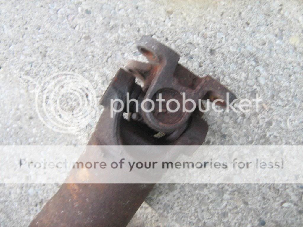

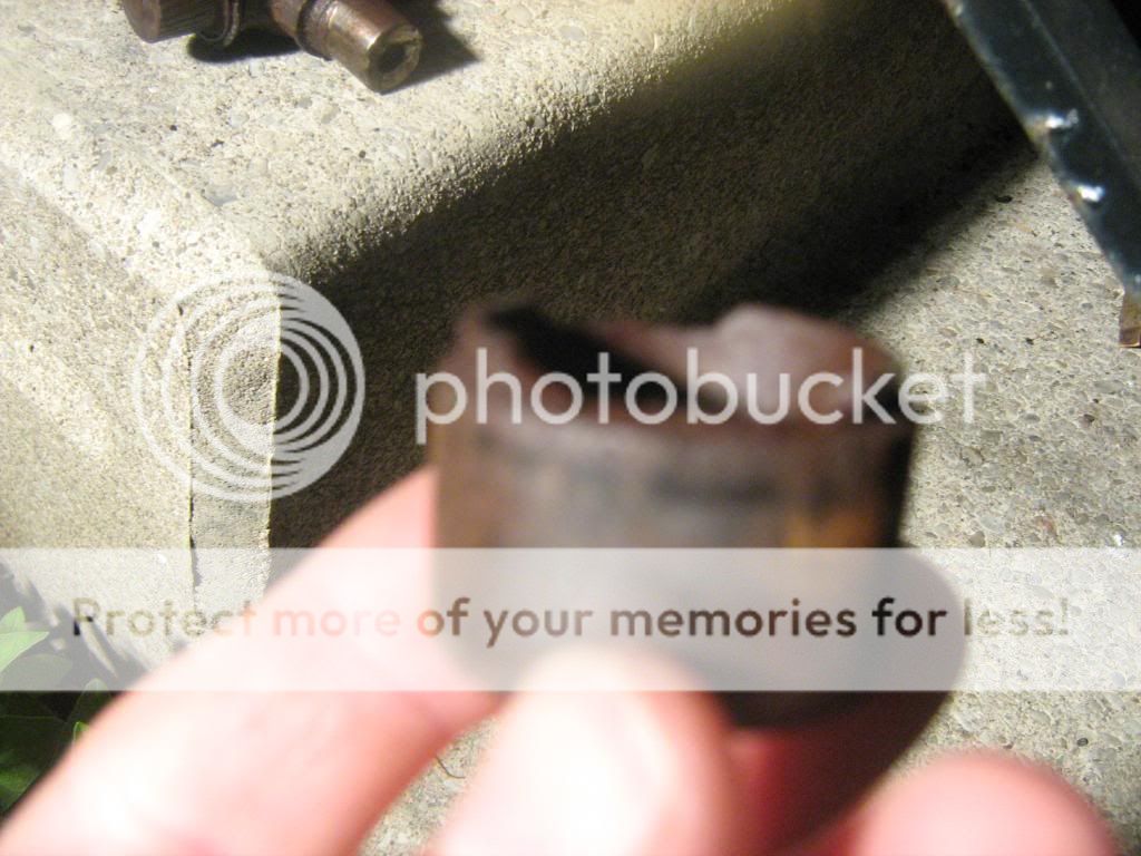

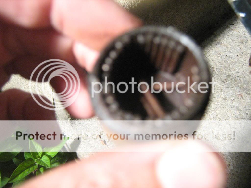

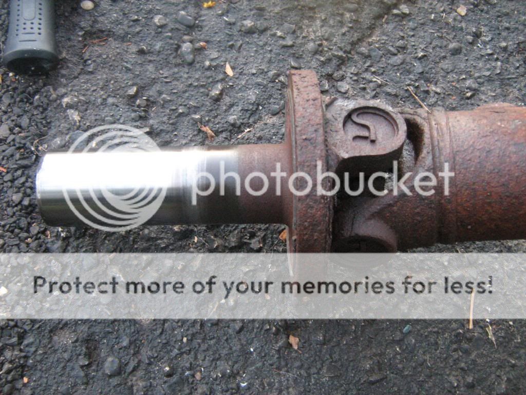

Now despite my own tranny and universal problems i couldnt help but think how could this happen to a brand new truck but yet here i am with a 10-11 year old truck with a trashed tranny and 2 seized universals .... why hadn't it failed? Ford tough or what? So long story short i thought i better do the universals today and i did, the tranny is getting all redone in october before plow season starts, My universals were in real bad shape and i still cant figure out why they havent broke after towing my 28 foot camper trailor, numerous cars ect........ the universals were missing the rubber seals.... all the needle bearings in 2 of them and also the end caps were all broke and missing pieces. Heres some pics!

There's your answer right in the picture, steel drive shafts. Aluminum and fibreglass just don't make good drive shaft material.

Looks like the grease worms have been at it..
