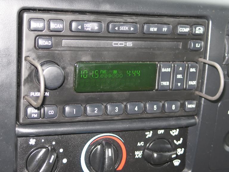

Are you replacing the radio or just need behind it?
what's your plan/agenda?
to get the radio out use 2 ford radio removal tools. they are a 'U' shape. They fit into the sides of the radio. 4 small allen keys sometimes work.. but the removal tools are way way easier
edit:
found this on google.
Different year.. but same concept/instructions .

Most aftermarkets for those years should just need a thin piece of steel on either side of the radio, after you remove the radio trim ring. About 18 ga. thick and 1/4 to 3/8 of and inch wide. Inserted in the left and right sides to release the catches and the radio should slide out. Sounds like he used the same plug for a new radio that's wired a little different, or it's not grounded properly.

sounds like they cut the factory plug off.
depends on the model of radio. some radio shops might "pop" it out of the cage for you.
or order some proper removal tools for that radio..
I don't believe the dash comes apart near the radio to access behind it.
possibly removing the ashtray area "may" get you some access to the wiring.
