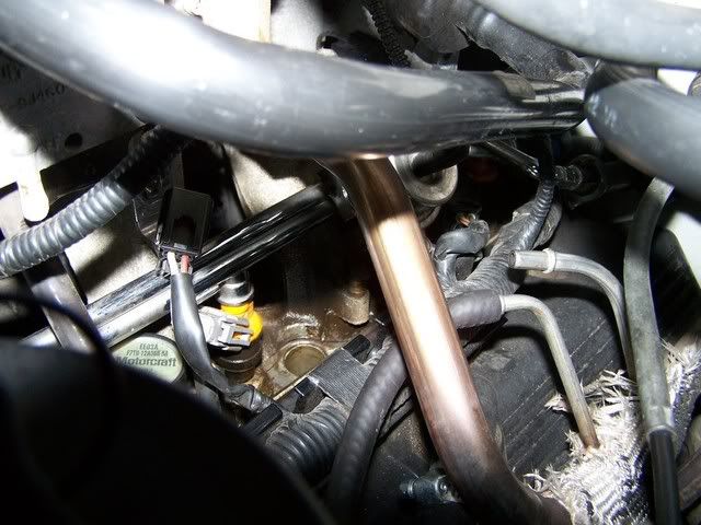

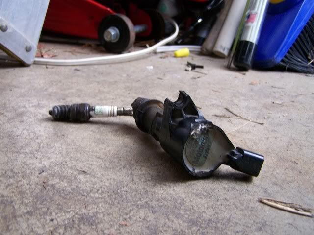

Aaaaah Crap my 5,4ltr 351 decided it didn't like the #7 cylinder spark plug so it spit it out.
The best part is I need a special healy coil kit,which is 453.00 =taxes and no one has one in Mission so I have to order the Healy coil kit which will take 3 bussines day to get here ^%#&#@$#@ HELP anyone in Maple Ridge or abbotsford have one????????

AGGGGHHHH Man that sucks.... Here is a link for a timesert kit this is the popular fix http://www.timesert.com/html/triton_repair2.html
Here's the video how to on using the timesert kit
http://www.timesert.com/video/Ford-sparkplug.wmv
