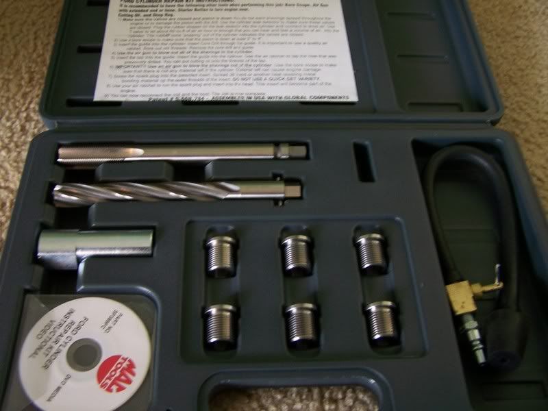

Tell me about it.I had to buy a special tool kit to fix the #7 spark plug the engine decided to spit out.
510.00 for the tool and 5 day's for it to get here.If you have the 5.4ltr you know what I'm talkin about.So now if it happens to someone else in my area they can rent it from me for 100.00 per plug.Nice Tool kit though.
Then I had to buy a slide hammer to replace the Driver's side front wheel bearing.(the hole damb hub with the abs in it.)But what can I say I got some cool tool's.
