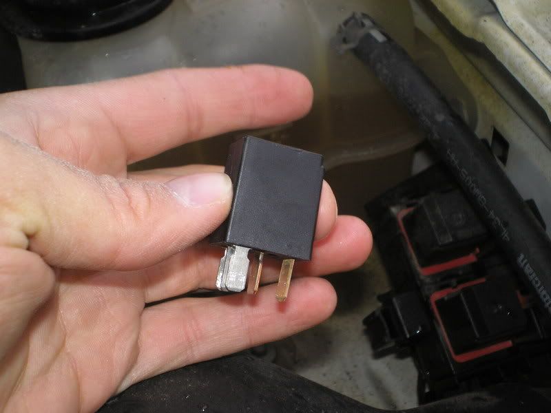

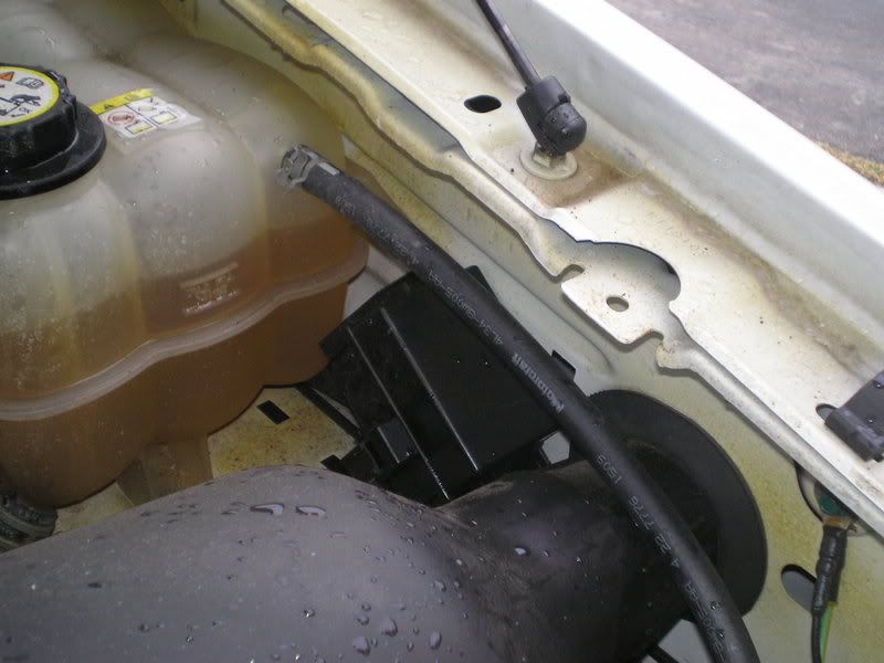

Open hood and fuse panel is on drivers side inner fender.

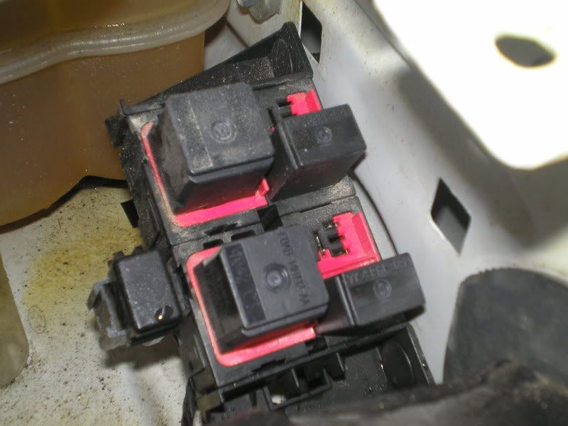

Use small screw driver if needed to open fuse panel.
Remove DRL relay which is indicated in owners manual. Then reinstall fuse cover.

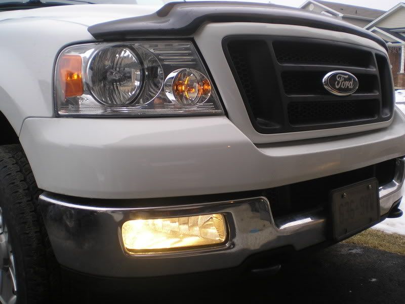

Finished result: no DRL's but you can still use driving lights
