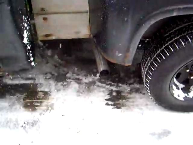

i had her running open headers for this sound clip

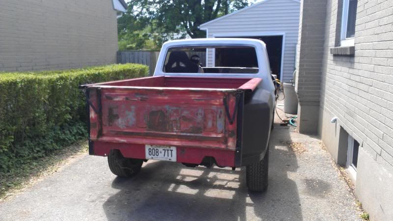

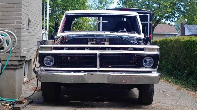

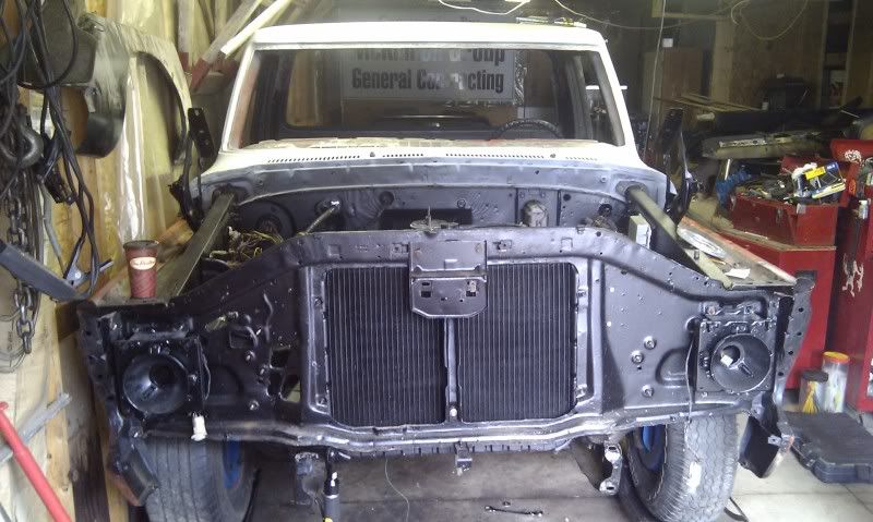

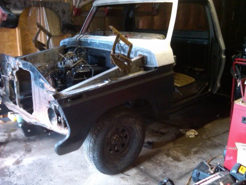

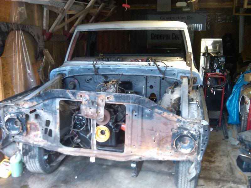

this is how she sits now
i still have alot of work

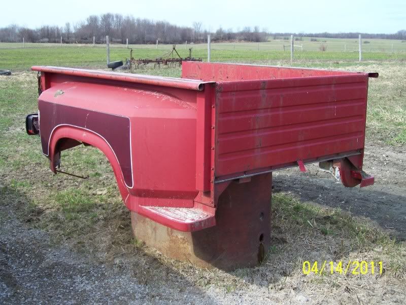

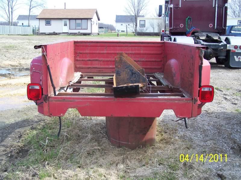

buddy ay works got a 79 f100
so i'm taking some interrior parts that i dont have
gotta finish little patches on the box i have for it and put it on wiht the wood floor
put the doors back on
then some final touches then she will be getting shiped out to get painted
then all the glass goes in
and she will be a complete truck again
problem is i cant drive it till 03/18/2014
because i'm not 25...yet
so this is why this truck has been under construction for this long
you may see that theres a lot of work ahead of me but really theres not
just big parts arent on the tuck
doors are off cause no room to open them
hoods off cause not enough light under it
box is off for repairs
gotta finish the custom dash for after market guages
the truck is drive able the way she sits but its not recomended

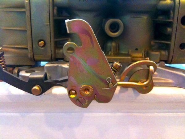

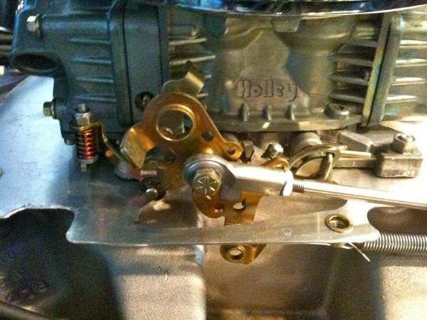

Benn, here are a couple of pics of Holley throttle linkage. I don't know if you are adjusting the right screw to drop your idle rpm down but the one you need to adjust is shown between where throttle linkage hooks on and secondary linkage is.
the screw your talking about it the one i was adjusting and had it completly out so the butterflys where damn near closed and it wasnt helping,
but i see how your carb is set theres 2 screws one on either side, thats the part i wanst understanding but now i do, i'l talk a look this weekend and see how things go with it

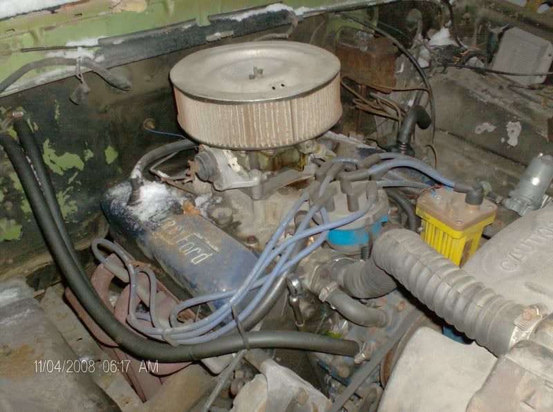

so after today in the shop,
my timing was out buy almost a full cylinder,
hope u guys know what I mean
I put piston #1 to TDC and I had to turn my distributor one point to the drivers side
and she fired right up and sounds a hell of a lot better then it did before.
i'm still having a problem with the idle, I did how ever add a 1inch carb spacer on
and its giving me problems and not wanting to idle right
so its got more air then fuel
so im thinking I should turn out my idle air fuel screws and see if that helps any
but other then that every things going well

Hey Benn, sounds like things are starting to come along. Any of us who have had a distributor out have had them go back in a tooth or two off. Just part of the learning curve. We've all had them go in 180 degrees out also because we got in a hurry and had them at TDC on exhaust stroke instead of compression stroke. Check your fuel levels by removing the screw on the side of the fuel bowl and watch for fuel to just trickle out the hole or level with the bottom of the hole. Adjustment is with the screw and nut on top of the fuel bowl. Idle mixture screws can be adjusted using a vacuum gauge to get highest vacuum and then turn screw in about a1/8 of a turn. You will have to go back and forth from each screw to balance them out. Until you can get the proper timing pointer it's going to be tough the set the timing. Just remember it doesn't take much of a turn to advance 5 or 6 degrees. Once you have the equipment to time it remember to disconnect the vacuum hose at the distributor and plug it in order to set timing and then put it back on the vacuum advance. A golf tee works great for temp plug on a vacuum line. Are you running aftermarket spacer or the Ford one with the connection for a brake booster? If you get a minute hook up your vacuum gauge and let me know what you are running for vacuum. Have fun.

I have the front and rear floats set, but looking through the screw on the side of the bowl, u give the truck a lil shake and fuel comes out, so its set,
and i'll be getting back to my motor this weekend,
i fought my proper timming pointer/finger, after looking for a few hours.
its on the motor, and my fkin timming light don't work. so
i'm gonna borrow a friends or buy one what ever comes first, lol
i only have one vacuum line
my carb spacer
is i believe a factory for one
1inch alum,
1 vac port, but its been pluged
i had it ground at work so its flat both sides

I had to pull the carb spacer out couldn't get the bitch to run
so after that, I got her timed and idling between 6-700 rpm
so everything is goo with this issue, carbs all set and she runs like a dream.

Hey Benn, glad to hear you got it sorted out. That spacer could have been a bit porus and leaking. At least you can enjoy it now.

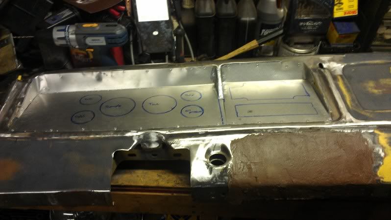

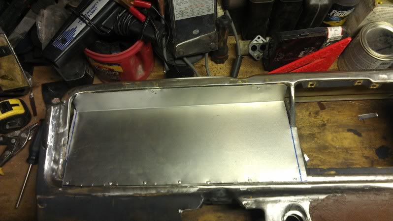

I still got a lot of work today I am up loading pictures not of my
custom dash I made jut gotta fiberglass it tom and bondo and paint
then cut the holes for my gauges , stereo and heat controls,
then gotta figure out where my switches are going
2
heres the pictures
its not perfect, but once i do the fiberglass work its gonna be nice and flat,
I did shave the ash trey and the glove box, i was missing parts to the glove box and its to small so i just shaved it.
