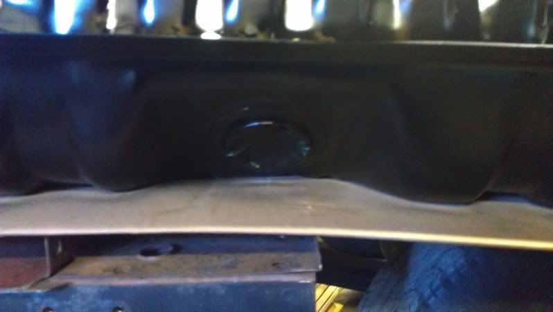

over the last couple days i'v been making great progress on my box sides
welding and grinding the patches
its gonna take some time but it will be done soon
then its on to the re assembly and get ready for paint then

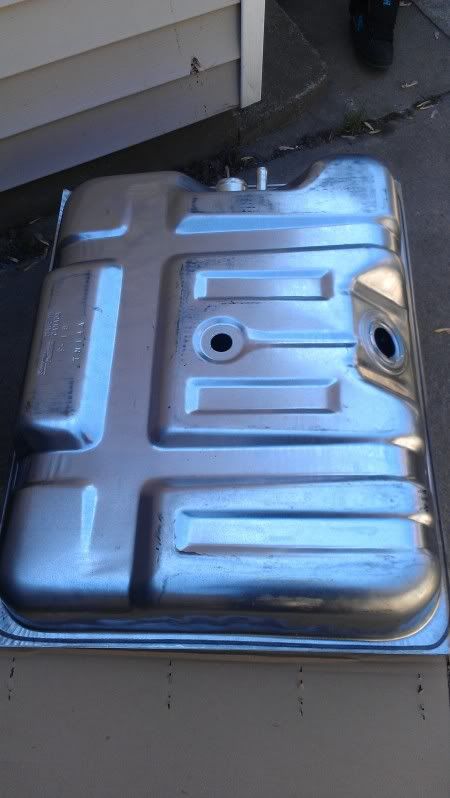

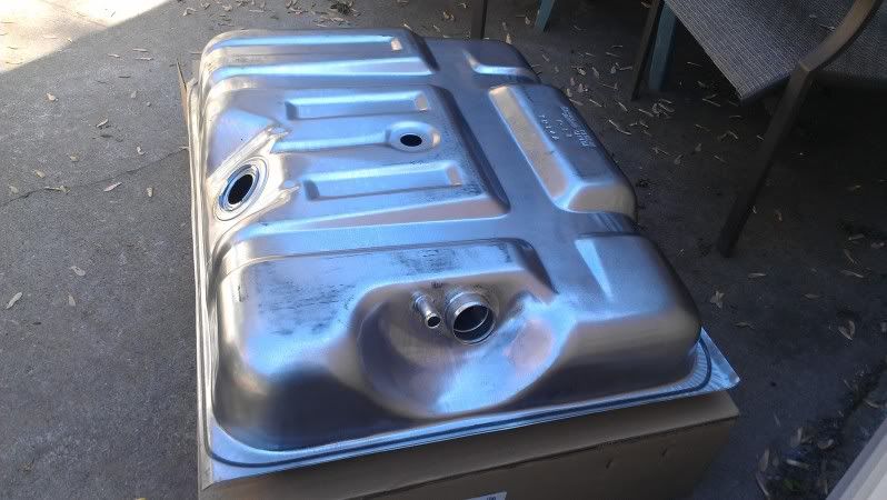

new gas tank comes in tommorow!(friday)
so i will be pick that up and painting it then, gonna install it and put some fuel in,

Gas tanks painted
Straps are painted
And she's ready to go in
I'll up load pictures once I get on to my laptop

in other news heres the pics of my gas tank

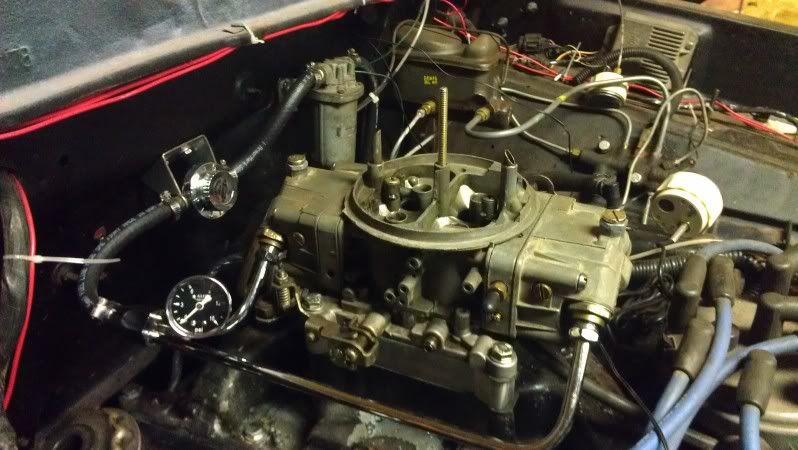

i did how ever buy a new fuel rail, fuel pressure guage and a fuel pressure regulartor.
yes i still have 2 guages that sould be in the dash,
there just there for now untill i do my custom dash then they will be going in
they look ok there until you get your engine tuned in where you want it:icon_cool:
hey whats with the larger 1/4" brake line for the rear brakes from the master to the prop?

yes its from the master to the prop,
thats the size of line i decided to use i could have use a 3/8 like the rest of the breaks lins but i figured this is how it was suppose to be
change it to 3/16" like the rest or you will have some funky rear brake problems and will probably screw up your prop valve.
